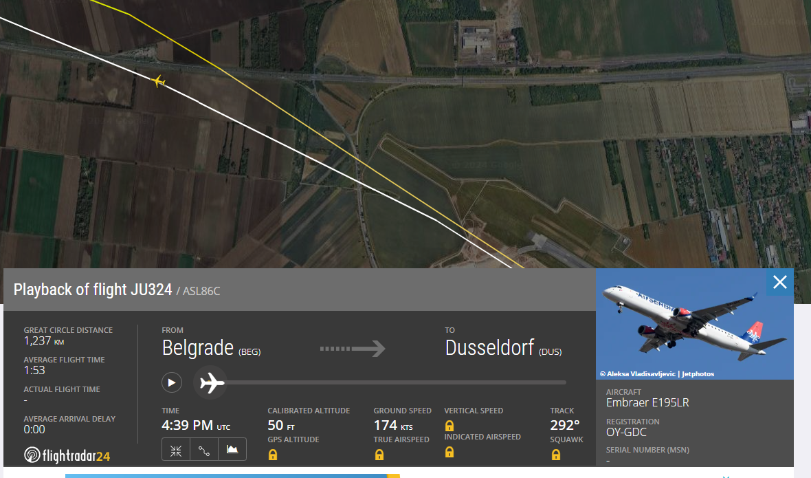

Још један коментар испод: "цимнуо улево" да избегне билборд?!
The plane almost experienced a disaster immediately after takeoff, because it barely avoided a huge billboard located on the approach road of the airport, almost perfectly aligned with the inserted runway. ILS antennas are light structures, but if the plane had hit the billboard, it would have disintegrated on the spot, and probably crashed in the middle of the highway, killing who knows how many people. On FR24, it can be seen that immediately upon take-off, the plane turned very slightly to the left, thereby saving itself. At the location below, see the streetview for a view of the billboards

Управу си у тренутку преласка преко аутопута је био на 50стопа-15метара али ја сам мислио на овај пут доле, који води са аутопута ка терминалу.
Ne mozes direktno da citas visinu sa FR24 iz vise razloga: Sample rate je mali da bi se ustedele performanse vebsajta, granularnost podataka je isto mala, i najvaznije, moras da uradis korekciju visine za pritisak i temperaturu. U ovom slucaju treba da se doda ~500 stopa na vrednost koju FR24 pokazuje.
